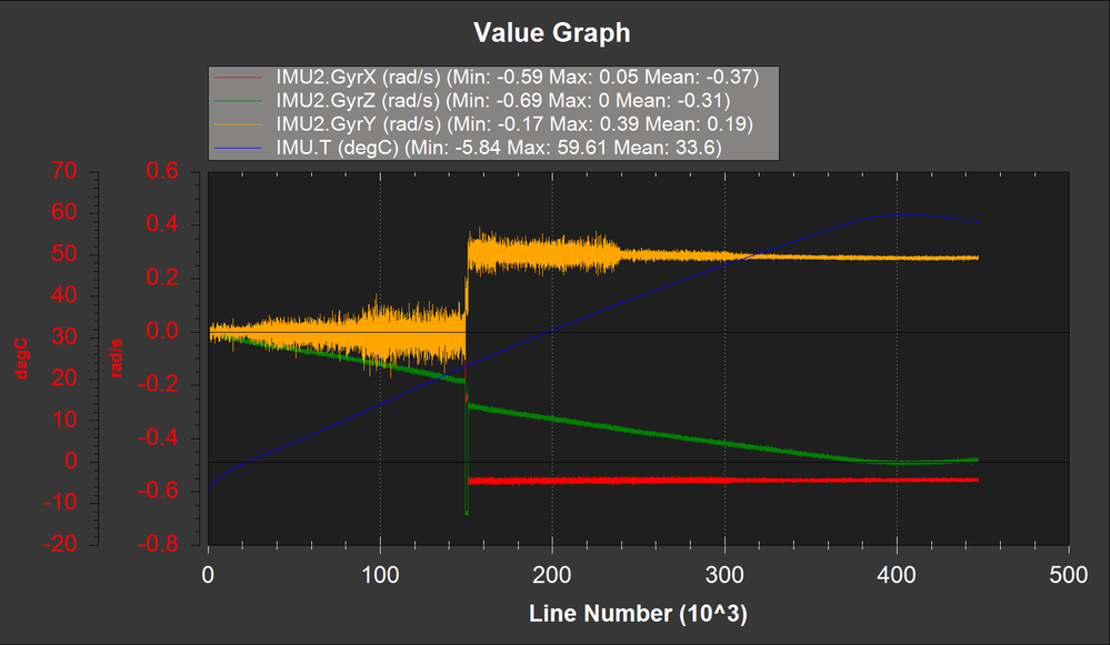

I'm using L3GD20H on a flight controller board for drones.
While conducting a temperature test that starts from -11°C and ends at 50°C, I observed a sharp rise/drop in gyro values at around 23°C. (The board stayed still the whole time inside a vibrating chamber.)
Can you give me any insight on why this happens or/and how to prevent it?

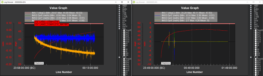

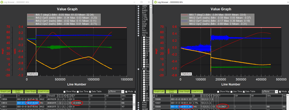

2021-03-15 8:37 PM
Hi @Eleon BORLINI ,
I double-checked and only 2 of my flight controller boards had the same issue.

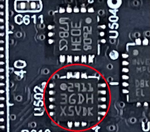

Also, it turned out that one of them was a fake chip posted on: https://community.st.com/s/question/0D53W00000cyCTnSAM/l3gd20h-fake-ic-issue
Anyway, I ran another test with the genuine chip in an environment with a different rate in temperature change (picture on the left),
And it also happened at 23°C.
(The picture on the right is the result from my original post.)

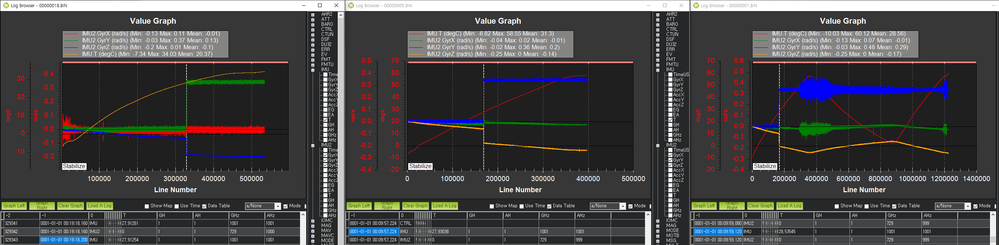

Also, I checked if this is a time-related issue. I left the board on for about 14 mins (left) and 2 hours (right) at room temperature and both didn't have the problem.
And FYI, the result of the fake chip, where the issue happens at 28°C.
So I'm still not sure what the problem is, the issue does not occur on the other duplicates with L3GD20H, with the same firmware.
