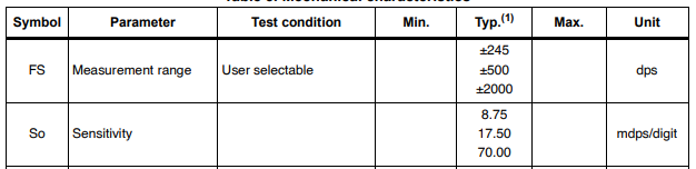

  1. Raw angular rotation data to DPS --> taking X axis as example, you have to concatenate OUT_X_L (28h) and OUT_X_H (29h) in a 16 bit's word and convert the value in two's complement. Finally, multiply it for the dps/digit of page 10 of the ds (the conversion depends on the selected FS).

Okay, so you mean, for example, that if my full scale is 500, I just take the concatenated 16 bit value and multiply by 500?
Eleon BORLINI
​Suppose you get value E2h on OUT_X_L (28h) register and value 55h on OUT_X_H (29h). You concatenate 55h and E2h obtaining 55E2h, then you apply two's complement conversion obtaining decimal 21986 and finally you multiply it for 17.50 mdps (= 0.0175 dps) obtaining 384.755 dps, if your FS is 500dps.
