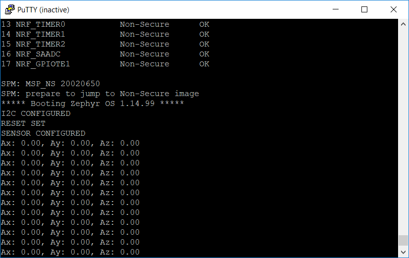

lsm6dso_reset_set(&dev_ctx, PROPERTY_ENABLE);, the program proceeds to the next stage but only gives zeros.
Can you please guide me on this issue?

2020-02-07 3:04 AM
Hello, Just solved this issue. I had to shift LSM6DSO_I2C_ADD_L to right by 1 bit.
