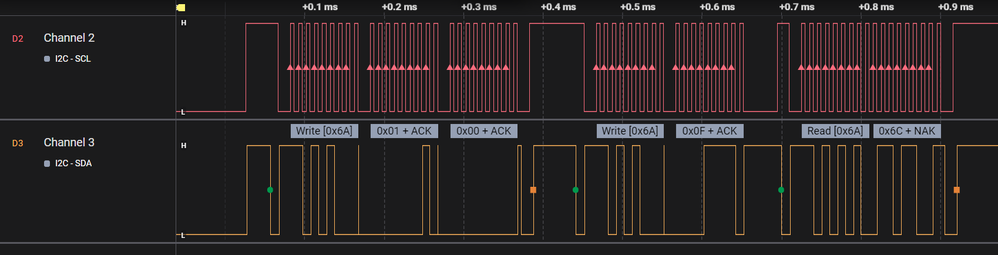

I am currently trying to get a lsm6dsox to interface with a Nordic nRF52833 board using i2c communication. I am looking to read accelerometer/gyro values.
I am able to write to the sensor but I am unable to read from the sensor without receiving a NMAK.
I am using the STEVAL-MKI217V1 adapter board to connect to my nRF52833.
I have connected the VDD/VDDIO pins to VCC, my SCL/SDA pins to the pins I configured for i2c communication, I have connected CS to VDD, GND pins to GND, and SDO to ground.
This is my result from the Logic analyzer
This is my source code:

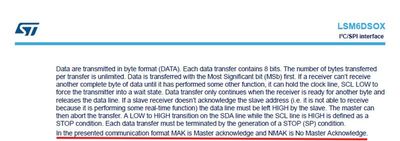

2025-03-07 8:19 AM
Hi @ReginaA101 ,
As written in LSM6DSOX DS, in the description of I2C communication, for READs transactions, the last ACK is a NotMasterACK.
I think that the protocol communication analyzer is not able to discriminate between slave and master ACKs.
