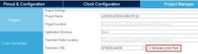

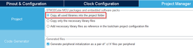

Sorry, I was testing some new unofficial CubeMX version and it modified the ioc. Unfortunately I have to say there is most likely some regression in CubeMX v6.11.1. After some modifications the project works but only in v6.11.0 and in unofficial v6.12.x.
Please completely uninstall v6.11.1 and then install v6.11.0 from st.com. Attached is the suitable ioc. Here is what I've changed to compile with 0 errors 0 warnings but maybe in 6.11.0 it could work without the changes, I didn't try.
There is also warning (in X-CUBE-ALGOBUILD v1.3.0) which points out that in demo_serial.c file in void Report_Error(uint32_t err) function the uint8_t buffer[24]; array has to be actually uint8_t buffer[260];. After fixing that you should generate correct FW. This has been fixed in v1.4.0 already.

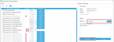

Have you updated capabilities.json/xml files to reflect your HW? Get the inspiration in example Projects in X-CUBE-ALGOBUILD package. Then you could try to migrate X-CUBE-ALGOBUILD to v1.4.0 in CubeMX before project generation (if not done already).
