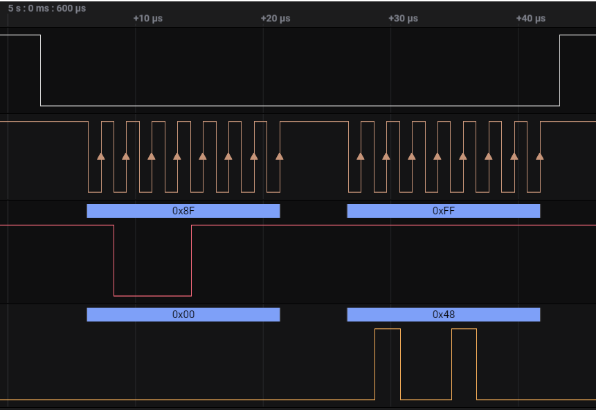

I am trying to integrate the ISM330DLC sensor (with Adafruit dev board). I am trying to communicate with the sensor using SPI, and I tested the communication by trying to read the WHO_AM_I register (0Fh). Attached below is a capture of the communication. And as it can be seen, the default result should be (6Ah), but I keep getting 48h. I cannot seem to find what the error is.

the digital patterns look good. Are you sure you are working with ISM330DLC? Can you please check the top marking?
-Eleon
