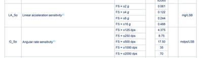

What are the units of the ISM330DLC reported values? Specifically
  • OUTn_G to units of acceleration (g)?
  • OUTn_XL to units of angular velocity (°/s)?

If you have multiply these values by the sensitivity they are in mg or mdps, otherwise they are in LSB.

Sensitivity there excellent, thank you Federica!! It has been awhile and I lost track of that
