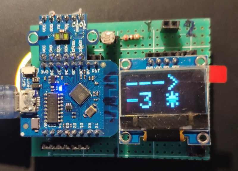

This example illustrates direction recognition with the single VL53L1X TOF sensor. Two Regions Of Interest(ROI) are defined in SPAD sensor array:
ROI1 ROI2
0,15___12,15
_____3,0 _____15,0

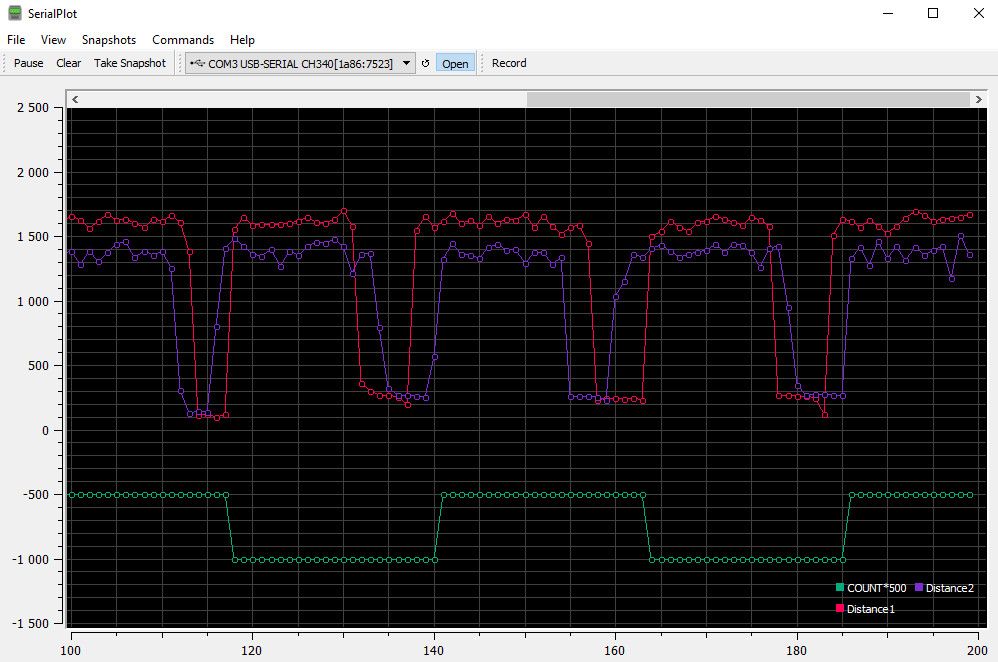

Data measurements distance0 and distance1 cyclically readed from both ROIs, switching them on the fly.
Then STM32duino_Proximity_Gesture library used for event interpretation.
To suit Arduino requirement I added necessary library description to Pololu vl53l1_api.
Also, to handle handMustCoverBoth parameter support in STM32duino_Proximity_Gesture library, I had to slightly modify tof_gestures_DIRSWIPE_1.cpp and tof_gestures_DIRSWIPE_1.h. Both libraries are included in this bundle.
This code is for WEMOS D1 mini Lite, but with board and pins adjustments will work with any Arduino.
Data outputs to serial @115200 and to OLED. For investigations and adjustments it is suitable to use SerialPlot: https://bitbucket.org/hyOzd/serialplot.
Files here:
https://yadi.sk/d/UIIAXFol3P_jXg
Video here:
