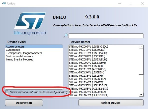

You can use different platforms from STEVAL-MKI109V3, for example the X-NUCLEO-IKS02A2 and X-NUCLEO-IKS02A3 boards (together with a NUCLEO-L476RG), but you have to use a STEVAL-MKI197V1. If you want to configure the MLC, I suggest you to do the acquisition with your LSM6DSOX, and then you can work in "offline mode" with Unico-GUI: you have to uncheck the "Communication" flag and you can upload the LSM6DSOX data acquired with the other platforms and configure the device in the way shown in the tutorial.

The problem is that when I try to configure the sensor, UNICO gives me this error: "The device selected is not supported by the motherboard".

You cannot interface the NUCLEO-L476RG + X-NUCLEO-IKS02A2 + STEVAL-MKI197V1 with Unico-GUI, since the correct GUI to use for the X-NUCLEO-IKSxxx expansion boards is UNICLEO-GUI.
Using Unicleo-GUI interface, you can acquire and plot the data as also Unico does, but you cannot directly use the MLC feature (Machine Learning Core) which is the distinctive feature of the LSM6DSOX. To configure this particular digital feature, you have to use Unico in offline mode as described above (no need to connect it to any board), after you have acquired data with the Unicleo-GUI.
