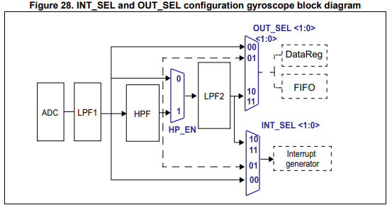

I get it. Still related to this, where can I get the values table for INT_SEL and OUT_SEL in CTRL_REG2_G (11h) ?
Thanks
2020-09-29 7:56 AM
Hi @PRebo.1 ,
the INT_SEL and OUT_SEL meanings are explained in the diagram of Figure 28.
-Eleon
