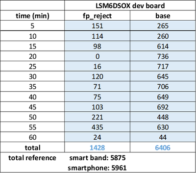

Thanks a lot for your kind reply. I have performed an experiment today and got the below results. The dev boards were grasped in my hand, and the smartphone was placed in my pocket. The data are just for your reference.
I was running for 1 hour the experiment (and there are some walks for temporary rest), seems the default configuration of fp_reject algorithm does not accept fierce activity such as running.

Hi @Jiabin ,
probably the position of the sensor is also involved in the low accuracy, maybe you can try again the test with the board in the pocket to be sure =)
anyway, remember that you can also tune the algorithm or even try to develop a Machine Learning Core network that is tuned to your running/walking logs to further increase accuracy =)
