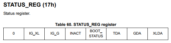

i am working with the LSM9DS1.
I want to read the accelerometer data using interrupts. The problem is that, when i enable the 'data ready interrupt'(INT_DRDY_XL) and read and printf STATUS_REG, to see whether one or more interrupts have been generated, it gives me back 0b00000101 . But it should be 0b10000101 because a new interrupt should have been generated.

2017-10-10 7:28 AM
The bit IG_XL in the STATUS_REG will not be set by
data ready. Accelerometer data ready signal controls the XLDA bit.
The IG_XL bit would be set by interrupt from interrupt generator configured in INT_GEN_CFG_XL register which you don't use.
