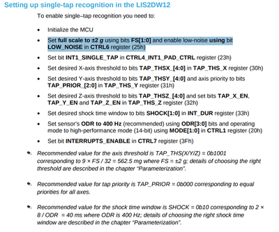

Thank you for your response. From your explanation, I understand that the maximum threshold can be configured as 31 × FS / 32. I would like to clarify if there is any restriction on the FS value when using the tap detection feature in the IIS2DLPC.
From the datasheet, my understanding is that tap detection requires FS to be set to ±2 g, although I may be mistaken. This requirement also seems to be indicated in another document, DT0101 Design Tip: Setting up single-tap and double-tap recognition with ST’s MEMS accelerometers.
Although this document describes the procedure for a different accelerometer, I assume the same requirement might also apply to the IIS2DLPC.
In short, I would like to confirm whether it is possible to configure FS to a value other than ±2 g while still being able to use the tap detection feature.

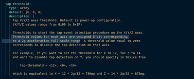

Hi @Federica Bossi
I have also found this in the zephyer binding file of iis2dlpc.
Could you please confirm whether tap detection can be used with the full-scale (FS) set to a value other than ±2 g?
Thanks!
