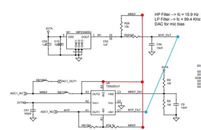

I am working on integrating IMP23ABSU into my hardware. Hence, I reviewed the evaluation schematic (steval-stwinkt1b) to understand its setup. I have a few questions regarding the schematic, in addition to what has been answered here, it would be great if you could answer them.
1. There are three MREF in the schematic for steval-stwinkt1b, part of which is attached to this message as an image below. I understand what the ones circled in green correspond to, but what does the MREF circled in red correspond to?
2. In the response here, it was mentioned that the amplification factor of 1 + R6/R7 = 2.34 is to take advantage of the microcontroller's 3.3V. But isn't the Opamp's VCC+ and microcontroller's VREF+ tied to 2.7V? Meaning the analog voltage range will be from 0 to 2.7V and the output M1P can only range from 0 to 2.7V, am I correct in interpreting the setup?

2024-08-29 8:07 AM
I'm new to this field, so please excuse any mistakes I might make. I'd like to make sure I understand correctly. Is my schematic accurate? If so, why is the 10k resistor not taken into account in the calculation? I was expecting a formula like 1 + (100 / (4.7 + 10)).
Thank you in advance for your help.
Best regards,
2024-08-29 11:52 AM
As mentioned in my previous answer: If you redraw the schematics around M1 and U8 again using pen and paper and using common symbols for microphone and the opamps, you will recognise its function.
But I will try to explain this in more detail:
Clear now?
Regards
/Peter
2024-08-30 1:11 AM
Thank you, sir, for your explanation, which is now very clear. Have a great day!
