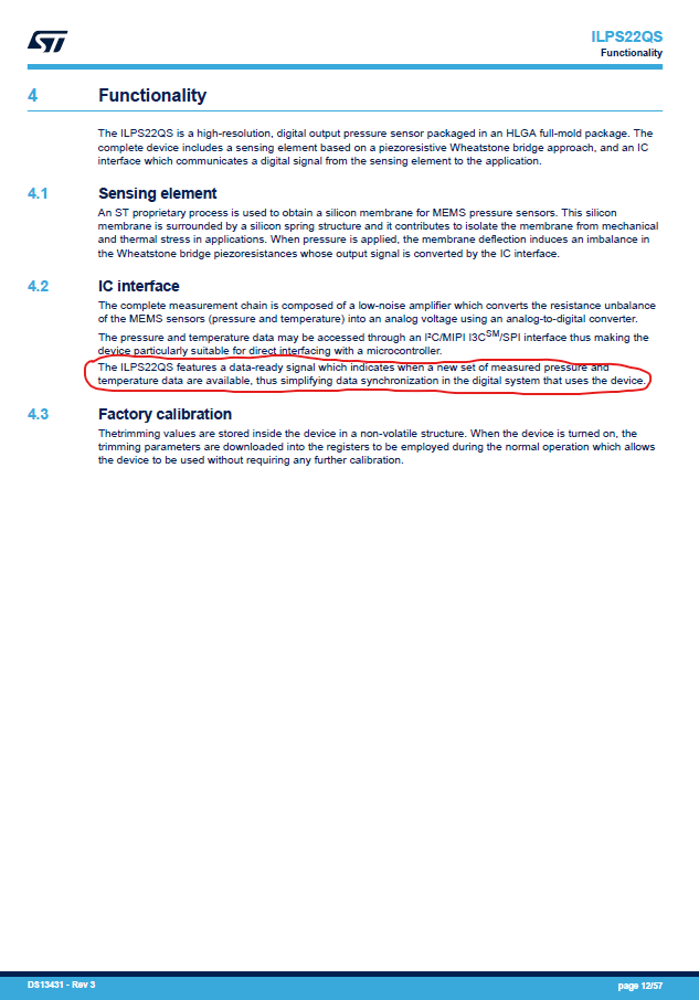

But here is something I don't understand. ILPS22QS does support interrupt functions: data-ready, FIFO flags, pressure thresholds with built-in interrupt generator block according to the datasheet, which probably means it should somehow be able to send down the DRDY flag to LSM6DSO, maybe through master i2c connection, allowing sensor hub operation to begin from there. Isn't ILPS22QS also capable for sensor hub operation as slave to LSM6DSO?

Hi @el659 ,
You can read the status instead of the interrupt to have the dataready.
Unfortunately you can't use the interrupts.
