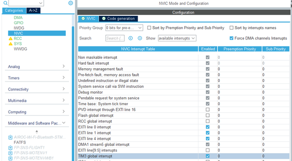

I have analyzed your .ioc file and you have to enable interrupt for TIM3.

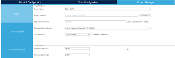

I recommend you to increase stack size as well.
After that it works as expected.

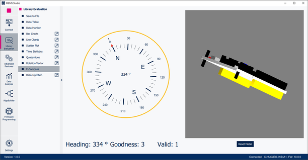

There is a bug in Unicleo-GUI which displays a DIL24 adapter even if it is not used, but this is only graphical issue, all the remaining functions work well. Anyway I would recommend you to use MEMS Studio which is our new tool.

Thank you Miroslav, set the TIM3 interrupt and increased the stack size, installed MEMS-Studio and now everything is fine. I am very happy. Thank you!!!!
