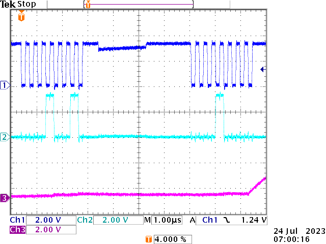

I have an custom board using the ISM330DLC but I'm having difficulty configuring it's primary bus for 3-wire SPI operation.
According to the ISM330DLC datasheet register CTRL3_C (0x12) must set to 0xC for 3-wire primary bus SPI mode to be enabled.

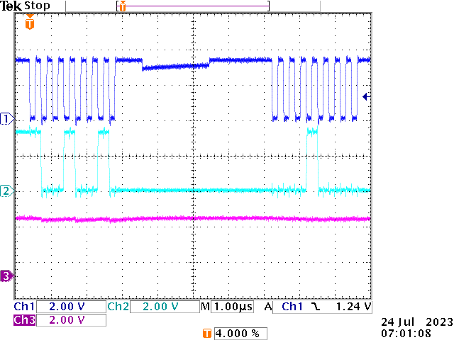

As can be seen from the following scope trace 0x0C is written to 0x12.
But when the 'Who Am I' register (0x0F) is read back 0x00 is received.
From the above I'm assuming that the CTRL3_C (0x12) command is not being received by the ISM330DLC as the SPI clock is not being pulled high as per the datasheet.
Before I replace the ISM330DLC can you please sanity check on the above?

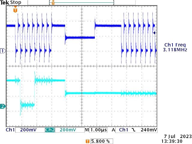

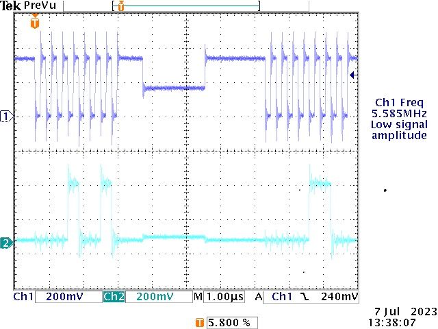

Find below the CS / Clock trace from the 'Who Am I' (0x0F) register read operation.

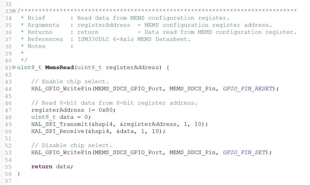

My SPI Register Read code is below which has no additional operations between the write and read function.

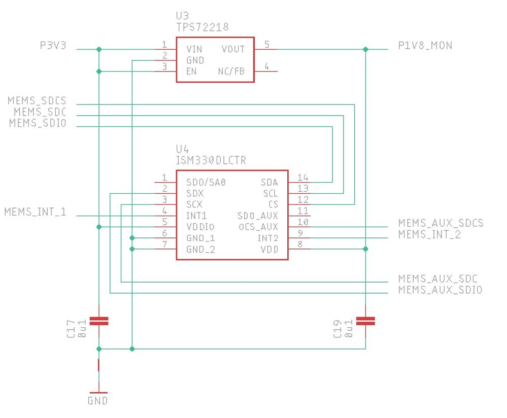

Hi Niccolo,
I removed the chip and confirmed that the PCB layout compared to the following schematic.
A brand new chip was then fitted but the results were exactly the same as before i.e. no response from the chip.
My end goal is to run the chip in Mode 4 but at this moment in time the MEMS_AUX lines are open circuit.
Regards
GnR

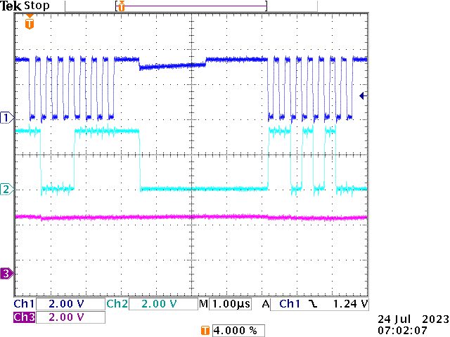

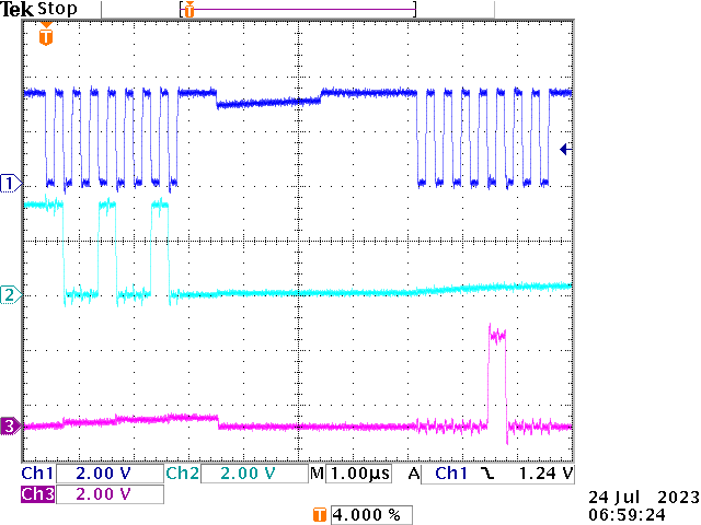

Hi Niccolo,
I managed to access to the SDO pin and i have made some progress.
Set register 0x12 to 0x08 to enable SPI 3-wire mode.
Then read register 0x12 and observed contents (0x08) on SDO.
ISM330DLC did not entre SPI 3-wire mode.
Experimented and discovered that if register 0x12 was set to 0x10 that SPI 3-wire mode was enabled.
Read register 0x12 and observed 0x10 on SDA, SPI 3-wire mode enabled. TEK00003.BMP
Question, is this a datasheet error or have I misinterpreted something?
Read register 0x0f (Who Am I) and observed 0xD4 on SDA.
Was expecting 0x6A as per datasheet, if 0x6A is shifted 1 bit left you get 0xD4.
The reading of registers must be correct as when 0x12 is read it is correct (see above) assuming datasheet error.
