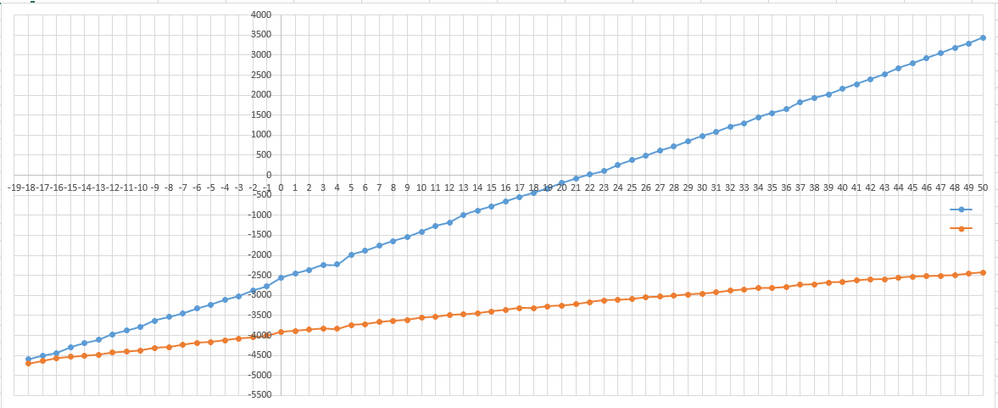

Here our meassurement. It shows the deviation in arcsecs over the temperature in °C.

The blue curve is X-axis; the red curve is Y-axis.

So you are plotting the LSB on y axis? Can you please convert them in mg according to the 0.076 mg/LSB sensitivity?
If I well understood, you found 1 on 3 devices with a TCOff of 0,58 mg/°C... this might be correlated also to the Vdd = 3.3V, which is different from the 2.8V of the datasheet and could increase internal heating.
