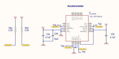

These are point to point lines (micro to the part) with 2.2K pullups on them thusly:
The problem at hand tho is that once here, how do I get out of it without a power reset?
Hi @RLee.4 ,
Thanks for the schematic, you could try to put a bigger value of R54 and R55.
Let me know if this helps.
Looking at the I2C lines, I've got everything from really nice to OMG what a mess so I can, on this board, see where I'm hanging the part.
The question I've got here is this: What am I supposed to do to get the part out of this state without a power reset?
