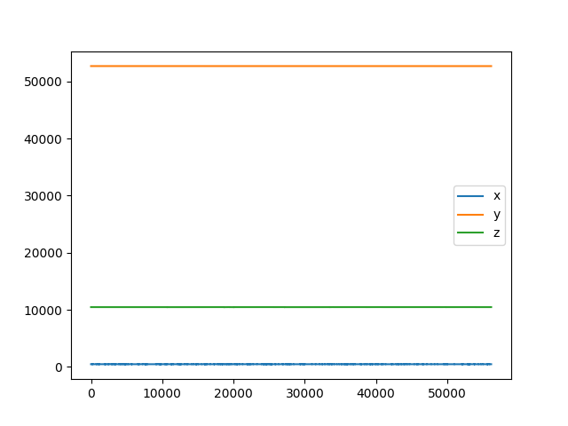

My Senosr board is on the table with no vibration event applied to it. Instead of seeing a value of zero or something close to zero, I am reading the X, Y, Z values as ( X=476, Y=52676, Z=10472).
What is the issue here and how to fix it?

x= 0x01dc =476
y= 0xcdc8 = 52680
z= 0x28e8 =10472
