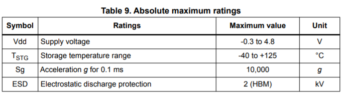

You also have to be sure that in your application you are not exceeding the 10,000g absolute maximum rating, for integrity reasons.
