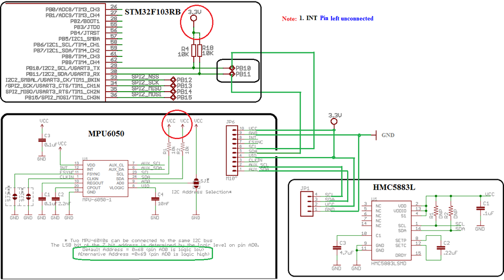

I have STM32-P103 board which uses STM32F103RB micro. I connected I2C sensors to I2C2 pins as shown below :

But now i use same files in another project which uses STM32F103RE micricontroller and sensor connected to I2C1 with 10k pull-ups( this time INT pin of MPU6050 connected to PB8, but not configured), rest of the things are same.

Below is the I2C analyzer debug information.
Thank you

2012-07-22 7:45 PM
Hi fm & Jack,
I'm rewriting my reply as there was mistake. Sorry for misleading you people.1. Configured the SCL and SDA pins as GPIO inputs (GPIO_Mode_IN_FLOATING) instead of I2C pins. Checked both pins to see if either is being held low, they are both held high. I tried to toggle the pins, but they are always high.2. Configured the SCL and SDA pins as GPIO outputs instead of I2C pins. Checked both pins to see if either is being held low, they are both held high. I could generate square wave.My understanding from the debug picture says, The SDA has to go high & come back to low in 10th clock cycle, But it is going high in 9th clock cycle & doesn't comes low, then SCL becomes low. This tells us that there is no acknowledgement coming from MPU6050. I also disconnected the SDA, SCL traces to MPU6050 on the board & connected them to a external working . Still the same problem persists. I think reset concept does not solve this problem.Thank you2012-07-23 7:18 AM
On your schematic the VLOGIC input pin on the MPU6050 doesn't seem to be connected to the I2C supply voltage. This might explain why the MPU6050 isn't responding to I2C commands.
Jack Peacock2012-07-23 6:27 PM
Hi Jack and others,
Jack & fm was right, It was my mistake that i did not connect VLOGIC pin to Supply. breakout board schematic was the reason to commit to this mistake as it doesn't show connection of VLOGIC to supply(3.3V).Once again thank you Jack & fm.Harinath2012-07-24 12:36 AM

I hade a look at the MPU60x0 datasheet yesterday, and I agree with Jack.
The VLOGIC pin is listed as power supply for the logic block of the MPU6050, but for the MPU6050 only. According to the datasheet, this pin is not connected at the MPU6000 derivate. I remember that a IMU300 which I have (from Invensense, like the MPU60x0) also has split power supply pins for analog and digital logic. That seems to be a speciality of Invensense.2014-02-06 9:52 AM
