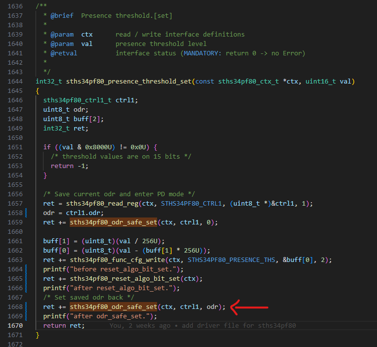

But it also happens oft: if the ctrl1.odr is 8, then it hangs by excuting sths34pf80_odr_safe_set
(if ctrl.odr is 0, the initial will be successful.)
int32_t sths34pf80_presence_threshold_set(const sths34pf80_ctx_t *ctx, uint16_t val)
  sths34pf80_ctrl1_t ctrl1;
  uint8_t odr;
  uint8_t buff[2];
  int32_t ret;
  if ((val & 0x8000U) != 0x0U) {
    /* threshold values are on 15 bits */
    return -1;
  /* Save current odr and enter PD mode */
  ret = sths34pf80_read_reg(ctx, STHS34PF80_CTRL1, (uint8_t *)&ctrl1, 1);
  odr = ctrl1.odr;
  printf("threshold set...1:%d\n", odr);
  ret += sths34pf80_odr_safe_set(ctx, ctrl1, 0);
  buff[1] = (uint8_t)(val / 256U);
  buff[0] = (uint8_t)(val - (buff[1] * 256U));
  ret += sths34pf80_func_cfg_write(ctx, STHS34PF80_PRESENCE_THS, &buff[0], 2);
  ret += sths34pf80_algo_reset(ctx);
  /* Set saved odr back */
  printf("threshold set...2:%d\n", ret);
  ret += sths34pf80_odr_safe_set(ctx, ctrl1, odr);
  printf("threshold set...3:%d\n", ret);
  return ret;

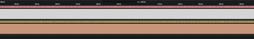

here is the output from the console:
Here is the signal on SCL and SDA:

after removing the last odr safe set function, everything works fine.
could someone confirm if this is really necessary, if not, I will remove it forever in my code.
//ret += sths34pf80_odr_safe_set(ctx, ctrl1, odr);

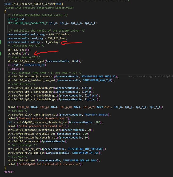

Hi @Federica Bossi
I added the mdelay and tested it, but for me it´s the same old.
here is my function:
