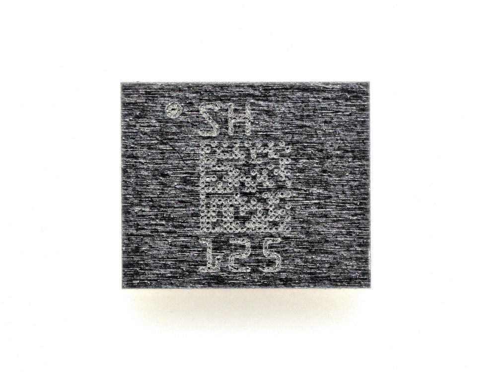

1) Part Number: LSM6DS3HTR
2) Date Code: 2125

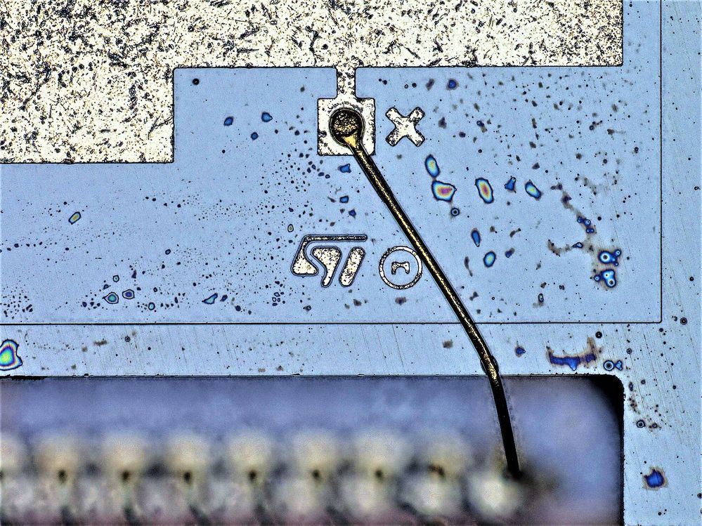

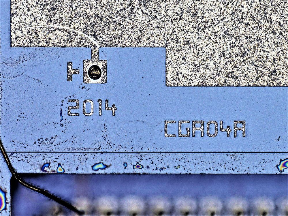

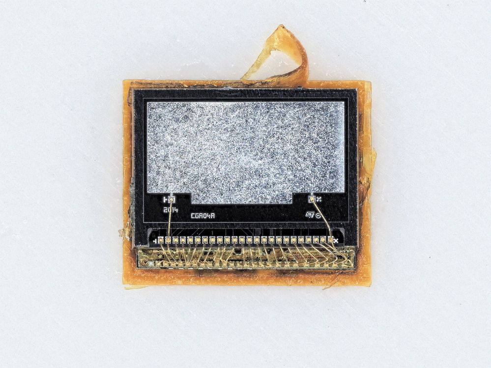

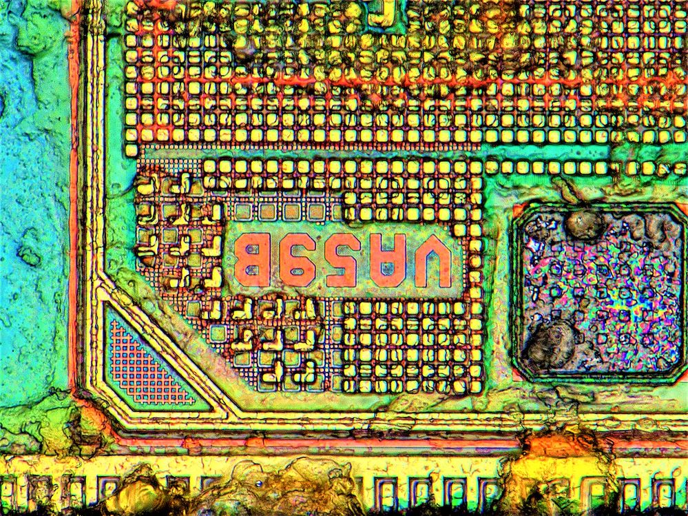

The markings on the die read:
1) ST, 2014, CGA04A, VA59B

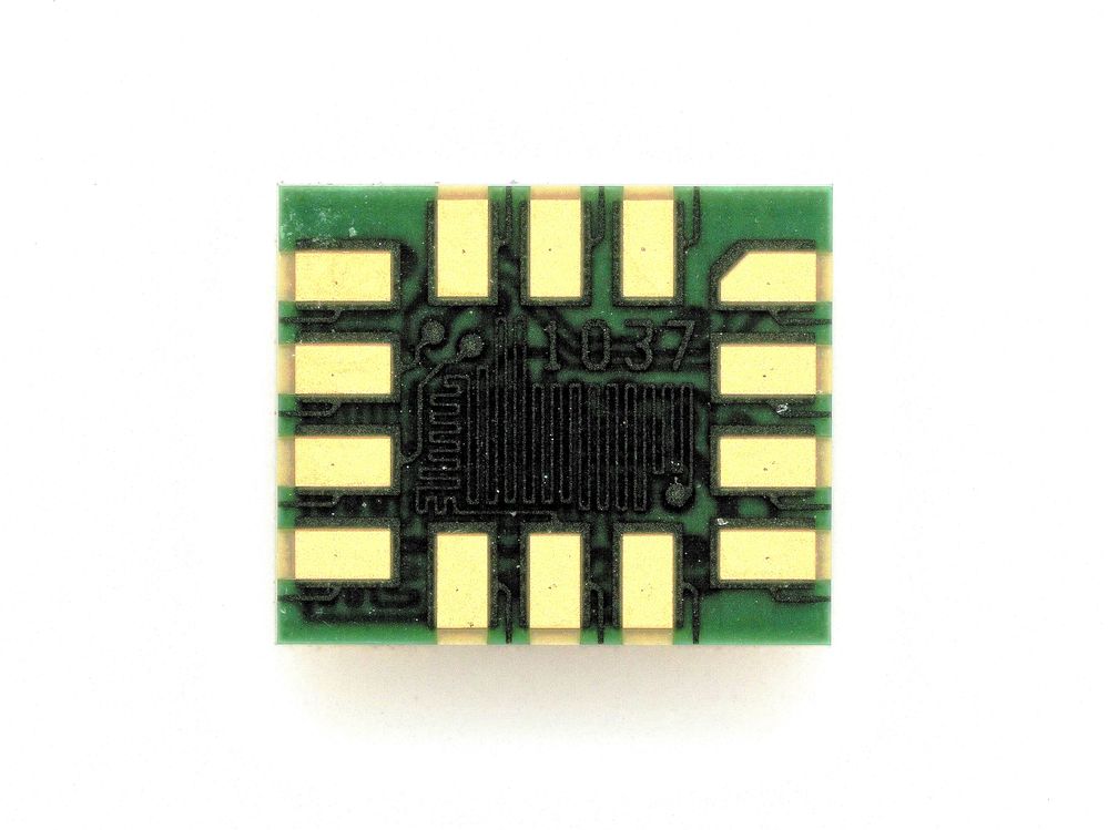

Of course. Here are the photos of my component, including the die and the die markings if that helps.

Oh, I see, you took the markings VA59B and CGA04A straight from the die itself.
However, there is no official information for this, but the package marking SH stands for LSM6DS3xx, e.g. for the LSM6DS3, LSMDS3H. Please note that the LSM6DS3H is discontinued. For more information, I recommend making a personal request at Online Support.
