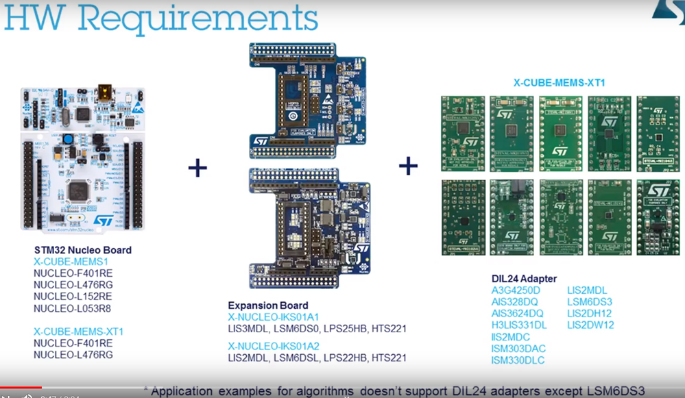

Hi @Rstua.1 , unfortunately the Unicleo-GUI package doesn't support the LSM9DS1 sensor :( Here below the screenshot of the supported sensors, from the tutorial video:
This because the LSM9DS1 sensor has two different interfaces (acc+gyro and mag), and the IKS tool can manage only one at HW level. You can of course start from scratch, "bypassing" the Unicleo-GUI and directly wiring the adapter to the Nucleo board... If you want a ready-to-go interface, it's better to switch to the Unico-GUI...
