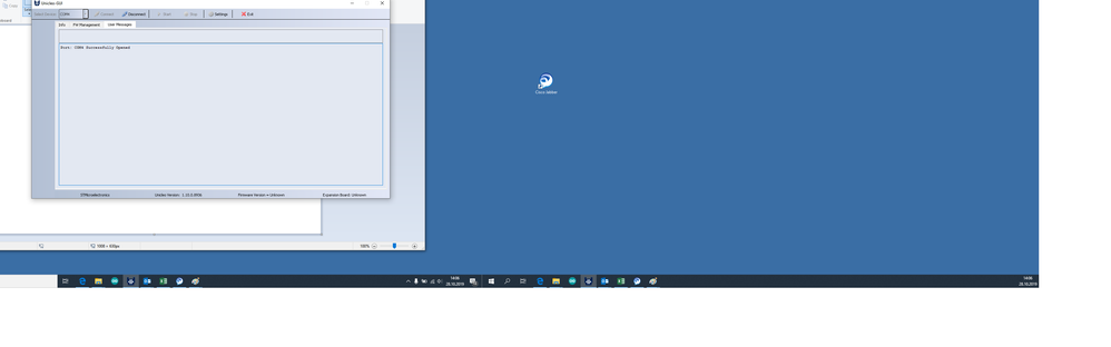

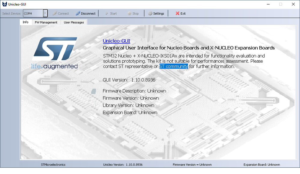

When I am trying to login to Unicleo GUI I am able connect to the communication port but the firmware description, version, expansion board name and library version in the login screen is showing unknown as I result , i suppose, am not being able to connect expansion board( I am using stm nucleo F401RE and the Nucleo –IKS01A2 expansion board).In the user messages it is showing that the successive port is being opened but I am not been able to get any communication with the expansion board as such .(I have already downloaded the virtual port driver as well and I have copied the firmware file from en.excube MEMS1 to user file as well)
Please find the attached screenshot from the Unicleo screen as well.

I have copied the .bin file to the associated disk drive as you have mentioned and the program is written to nucleo board then too after opening the unicleo GUI I am seeing the same log in screen as above......I will explain more further what I did,I went to project folder selected the expansion board and the I have selected one action for instance Ecompass and copied the binary file to the drive and the program was written but still when I am opening the unicleo-GUI I am not been able to see any the options...
2019-10-30 4:01 AM
Dear Miroslav,
it was actually the com port that was causing the problem.....I have changed the port now it is being working quite good...…..Thankyou again for your time and support
