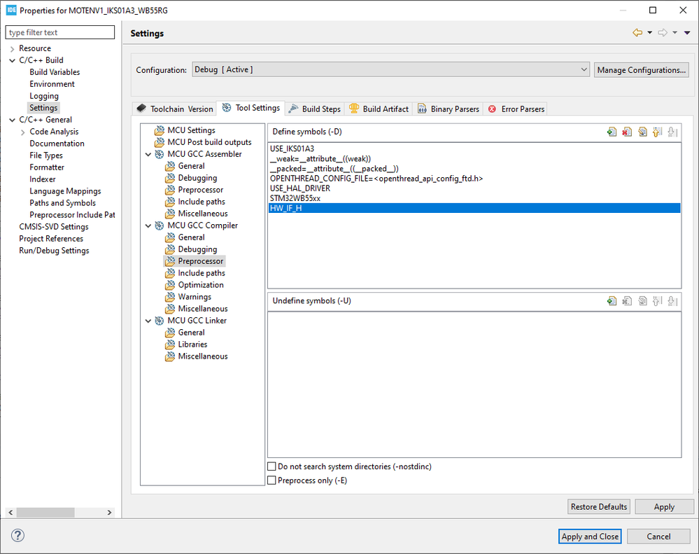

The final solution for me was to use the recursive inclusion prevention define to automatically exclude the content of that file by adding -DHW_IF_H to the compiler definitions. This way I didn't have to edit app_conf.h after each STM32CubeMX regeneration.
Steps:
Go to the project properties
C/C++Build - Settings
MCU GCC C Compiler - Preprocessor
Add HW_IF_H in the Define symbols list:
Second thing I realized after enabling the UART1, the peripheral initialization call is not added in the main, unlike everything else. is there a good reason for that?
See below, I had to add the call in the user code section for the UART to work:
