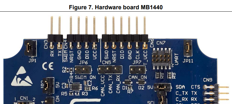

you have to connect the CN6 connector of the ST LINK V3 shown in the picture below
to the 5-pin SWD connector for programming debugging on the Sensortile cradle expansion (STLCX01V1), p.9 of the user manual UM2101, through a flat cable.
0693W000005COS8QAO.pngPlease assure that the SWD pin on the first connector is linked to the SWD on the second connector.
You can also use the SWD connector on the cradle device STLCR01V1.
