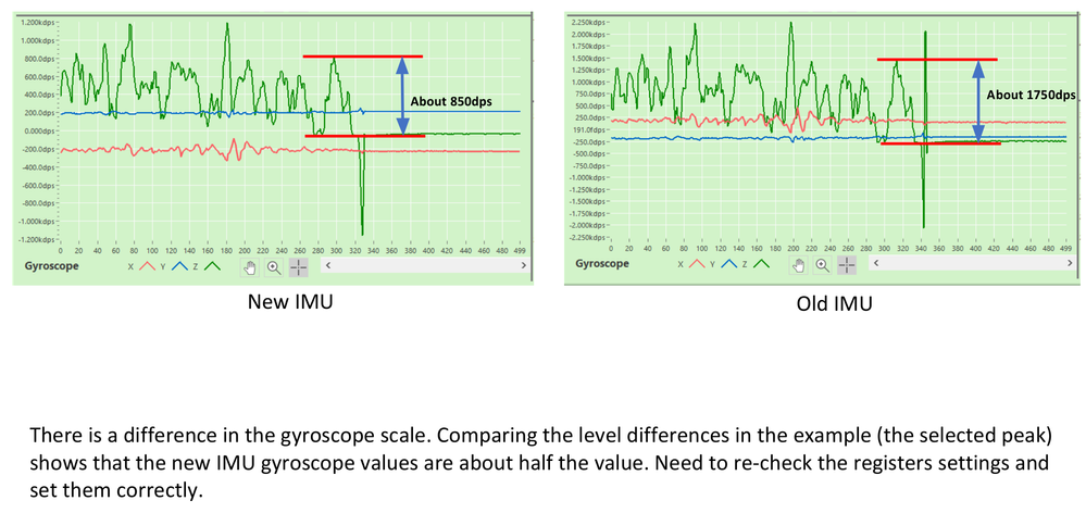

There are actually two problems:
  1. The frequency response, which is lower in the new one
  2. The signal level of the 3 gyroscope axes is half the scale. You can clearly see it in the Z axis because of this specific recording but the 1:2 relation is also at X and Y.
I attached a PPT screen shot of the results comparison between the two: Please make the picture as bigger as you can to see the differences.

Hi @Evyatar Nassie​ ,
that's strange, are you configuring the two devices exactly in the same way (same ODR, FS, filters, etc...)? And did you test more than 1 device?
