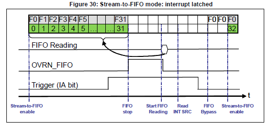

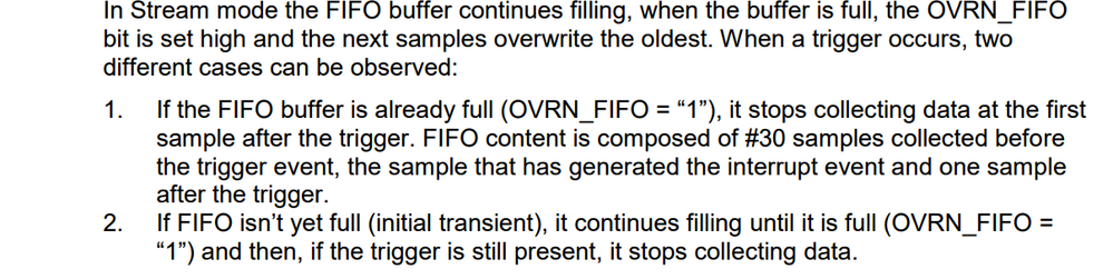

Thanks for the reply. My understanding is a bit different. In AN3308, it describes following about the stream-to-fifo mode:
So as my understanding, if the case 2 happens, we are still not able to know where in the fifo the trigger data is. Right?
So do I have to read back all the 32 data sample in the fifo and compare to the Threshold I set? The first sample in the fifo that exceed the threshold is the trigger data.
2018-03-15 9:43 AM
You are right, in case 2 you want be sure which sample corresponds to the interrupt and you have to compare each sample with threshold. But this case can happen only when you start your measurement, after 32 samples the FIFO will be full and case 1 will happen.
