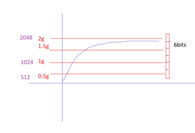

1. When the sensor is set to 2g and I use the WK_THS[5:0] configuration, setting the register to 000001 corresponds to 2g/64 = 0.0312g. However, I'm trying to determine what this value represents in the recorded signal, which appears to range from 2048 to -2048. Does WK_THS[5:0] = 1 correspond to 0.0312/2 * 2024 = 31?

1. Yes you are correct. It would be 31mg as a wakeup threshold.
