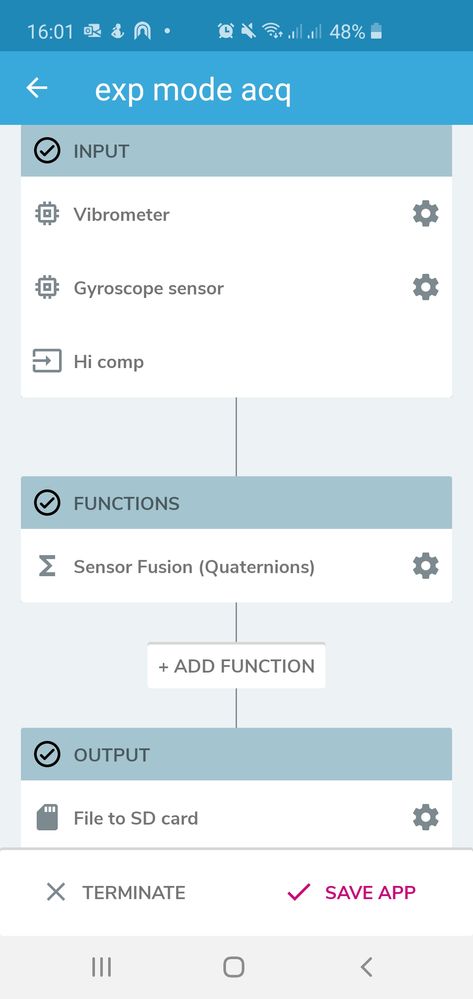

Hi @VRao.1 , please find attached my answers below:
>> for this project I wanted to use multiple sensortile box modules
You can only pair a device and a ST.box per time: if you
>> However I am not sure how I can use this library to send only the heading direction of each sensortile.
You can and select the Euler angles or the Quaternions from the functions in expert mode and you can check the graphs directly on the apk or stream the data on the SD card or on your PC via USB (if you just want the raw data).
