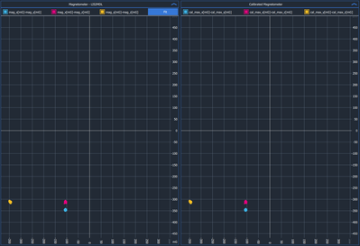

Petr S
You're right, only magnetometer data are needed. But the data in your last datalog shows you're not rotating the board at all.
You need to rotate the board around all 3 axes (ideally more than 360° around each axis). Then the elliptic magnetometer data are transformed into sphere and shifted to 0,0,0. The transformation parameters are actually soft iron and hard iron calibration parameters. See the example of my datalog I sent you before:

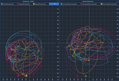

Aha, ok, so please send me your datalog with rotation around all 3 axes and I'll simulate it here to see if the problem is in your data or in your code. Again I really suggest to compare your code with MagnetometerCalibration application code in latest X-CUBE-MEMS1 package to see if you do everything the same way, especially if there is some data conversion and so on. Every detail can count.
Hello @Petr S
Here is the data log that i have logged with rotation.
Please find the attached.
Thank you!!!
