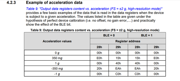

As per the datasheet, I understand that it always shows +1g on the +Z-axis when the IC is at rest.
We are operating the sensor in HR mode under different modes 2g, 4g, 8g and also in 16g mode. But strangely the raw values are always near 16384 (0x4000). I tried the same experiment with Low power mode and also normal mode. Still, the values are the same. I tried tilting the board making the X-axis and also Y-axis point to the sky, in that case, the respective axis shows a raw value near 16384 always.
If the respective axis is pointed towards the earth, then the sensor reads a value near -16384 (0xC000)

Either the sensor is completely broken or you haven't switched it out of ±2g mode. Your values are exactly as expected for the force due to gravity when right side up (0x4000) and upside down (0xC000) per the table.
Calculations in higher modes are literally the same except a multiplier is used at the end (x2, x4, or x8 for 4g, 8g, or 16g modes, respectively).
Expected values of ±1g in ±4g mode would be 0x2000 and 0xE000.
