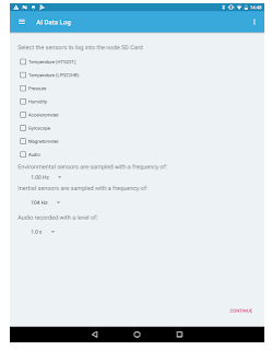

I have instaled the "ST BLE Sensor" on my smartphone and made some data collecting using accelerometer sensor. I have seen on the APP presentation that is possible to choose the frequency but I didn't find this option in the APP. I am seding a image of the APP section that show the option. If somemone could help to find this option, it will help me a lot on my researches.
Thank you.

Hi, I double-checked with our Bluecoin experts and we think it is not possible to change the ODR / rate settings directly form the app. I suggest you a longer way, if you want to going on in using this evaluation kit for deeper tests: you could change the FP-SNS-ALLMEMS2 on your PC in the right part of the code with your desired rate (ODR), and then download the modified FW on the Bluecoin. Btw, which is your target application (it will determine the acquisition band of interest)? Regards

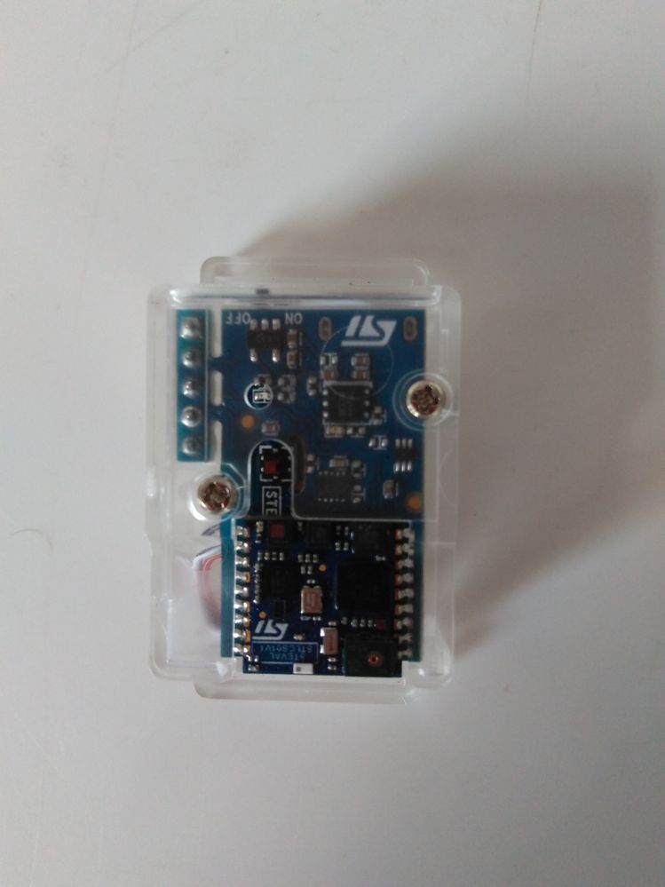

Find attached the photo of my devices.
Best Regards.
