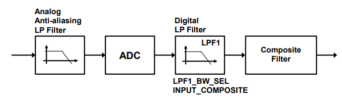

Do we risk folding of out of band high frequency vibration components down to the band of interest.
Appreciate any level of information you can share here.
2022-06-17 1:12 AM

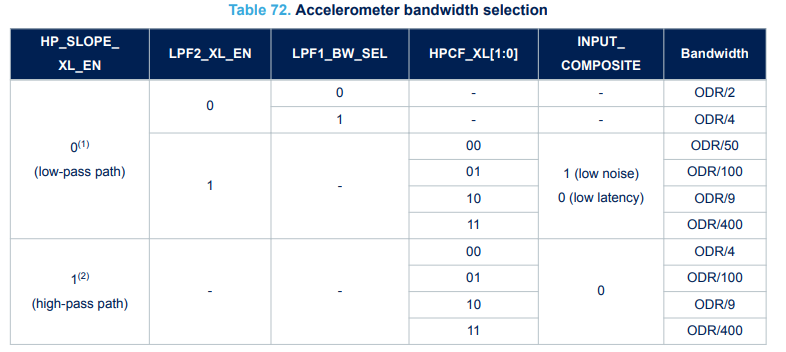

Hi @GSvoe.1 ,
the anti-alias filter is an analog filter just after the preamplifier, that cannot be configured in bandwidth.Instead, the downstream filters can be set according to, and the cutoff rate in this case is directly related to the ODR, according to the following table of the datasheet p.55:
The MEMS bandwidth (only for accelerometer ODR ≥ 1.67 kHz) is about 1.5kHz, see CTRL1_XL reg configurations.
