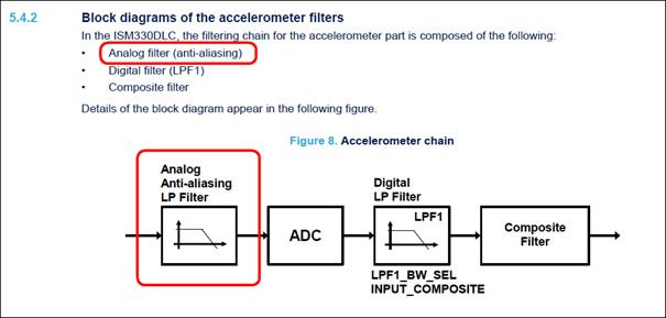

I would expect a signal chain for the IIS2 and IIS3 similar to this one....0693W000007DmSbQAK.jpg

No, there is no analog anti-alias filtering just before the ADC of the IIS3DWB and IIS2DH.
In both cases, the mechanical structure of the accelerometer MEMS sensor acts as a low pass filter, preventing a significant fraction of the aliasing issue.
The fact is that the anti-alias filter is -at a practical level- limiting the bandwidth of the sensor, and for the vibrometer having a broad band (up to the 7kHz resonance frequency) is fundamental.

Hi Eleon @Eleon BORLINI​ ,
thanks for your quick reply ;) I had thought so that the mechanical structure of the accelerometer would act as a low pass filter. But for me it was important to have this confirmed again, thx.
Am I correct that LPF1 for the IIS3DWB is neccessary to limit the signal bandwidth on less than the resonance frequency of the sensor axis? Because an actual gain caused by resonance is not desirable and could be misinterpreted?
