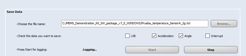

I have a LIS3DH sensor and Unico 7 in my computer and I am using the evaluation board MKI109V3. The thing is that I want to save the temperature data (measured by the Embedded Temperature sensor inside the LIS3DH) in a log file and with Unico this is only possible for Accelerations, LSB, interruptions and angles. It is not possible to save also Temperature? How can I do it? If not, how do you recommend me measure and save this data?

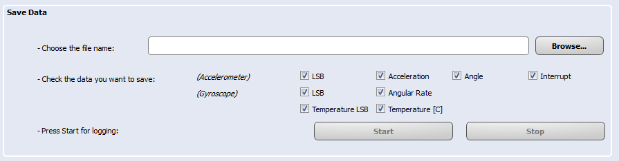

hi vicente, which .dfu version are you using? Please check if it is ProfiMEMSToolV2.30.3. In Load/save section, you should have something like this:

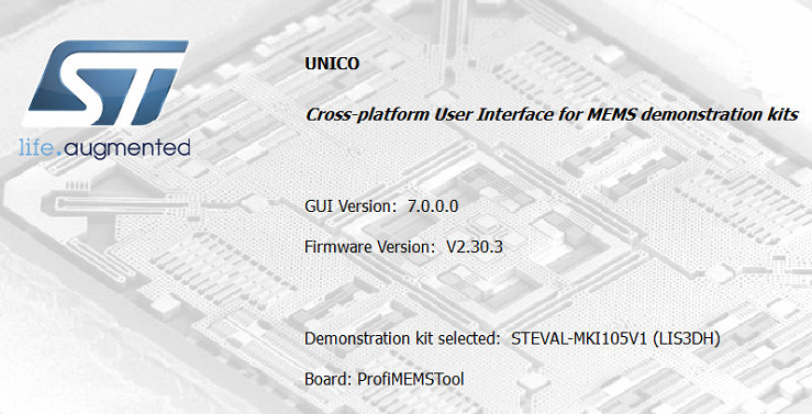

Yes I uploaded the ProfiMEMSToolV2.30.3 that is in the DFU folder of the MEMS Demonstration Kit SW package for the MKI109V3. In the Load/save section I only have these options. Perhaps the Unico version is not recent? It is the 7.0.0.0.

Hi Eleon, I see that there are options for gyroscope too. Is that the same sensor? I am using a LIS3DH with MKI-105V1 adapter.

hi vicente, I posted the most generic interface. Unfortunately, for some sensors there is only a subset of automatically-saved data.
