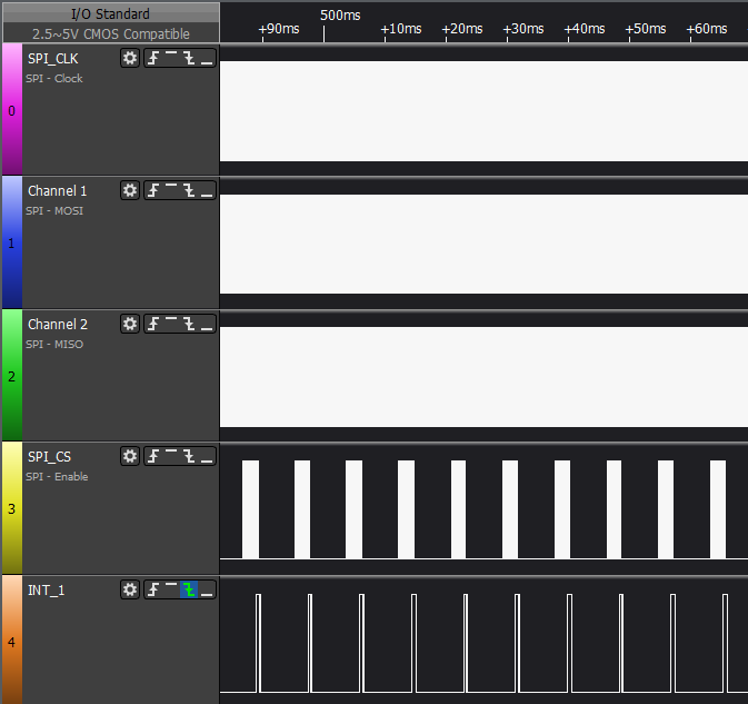

iis3dwb_pin_int1_route_set(&hAcc, &int1_route);I checked with a logic analyzer and the INT1 is happening.
I'll test the results and apply a FFT to analyze the response frequency, but I think this resolve the issue.
