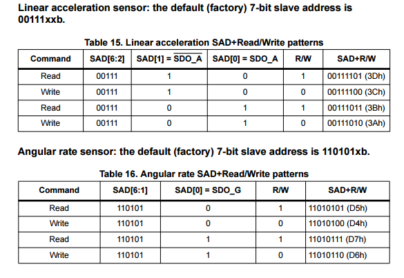

In the datasheet, each function has different I2C slave address:
If using I2C, check if you can read each function WHO_AM_I register usually located around @0x0F

I'm using I2C intarface. In the circuit, SDO_A pin connect to VDD. So I use the 0x1D as address. When I read WHO_AM_I register, there is nothing changed. Again, I can't read anything. I wrote BW, Scale, ODR, axis and BDU for register settings.

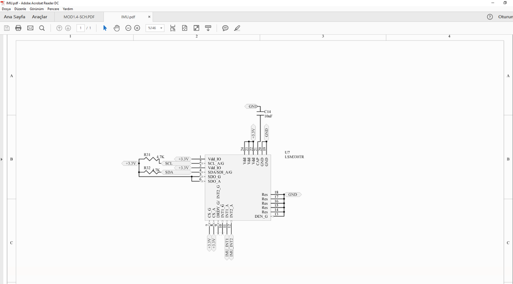

Do you have CS_A and CS_G both connected to '1' (Vdd_IO)? Can you share you schematic?
If you are not able to read even WHO_AM_I register the problem would be probably in I2C configuration or in the HW connection. Also capture of I2C communication from a logic analyzer would be helpful.

Yes,I have and I could share my schematic. If the problem was from the i2c configuration, I do not think I could read gyroscope data or if the problem was from the HW conncetion, it should be in LSM330. In this status, what should I do ? How can i solve this issue ?
2017-05-25 5:31 AM
The schematic seems OK to me.

As accelerometer and gyroscope share the same I2C, the problem you see is really strange, can you double check you use correct I2C address of the accelerometer.

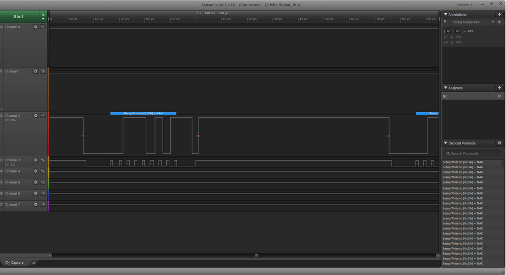

I'm going to look with logic analyzer. I checked both of the addresses and the software is returning an Acknowledge Failure Error. Well about this sensor, are there a source code or are there different document from datasheet ? Can you share with me ? The problem might be in my software of accelerometer.
2017-05-25 9:14 AM
I share the image of the result I obtained when I observed the i2c communication from the logic analyzer. It's always giving me NAK.
