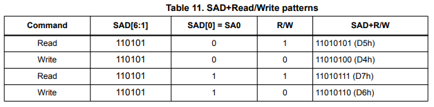

1.As you can see from the table below (you can find it at p.38 of ISM330DHCX datasheet), the SAD is composed by 3 parts, and the proper I2C slave address is the SAD+SA0. So the two possible I2C address values are 6Ah and 6Bh. SA0 value is determined by the PIN 1 hardware status (if SA0 at GND, the value is 0, while if SA0 at Vdd, the logical value is 1). So in your case the SA0 pad should be at Vdd.
