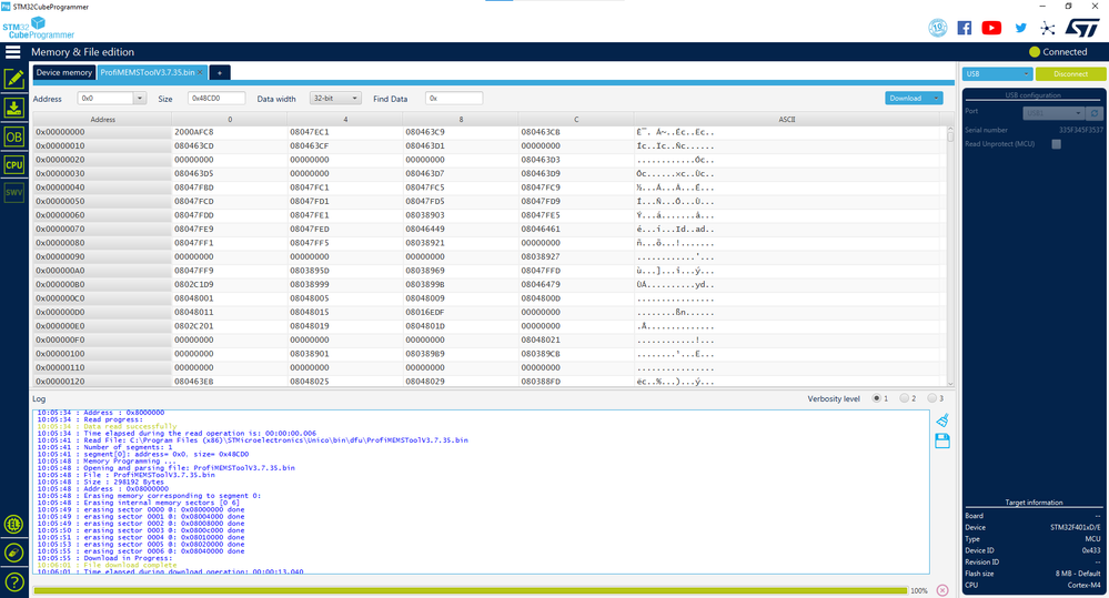

I followed the tutorial step by step via StM official youtube channel (https://www.youtube.com/watch?v=6QDYSWU3bD0). Also before i had tried previous tutorials.But there was such a problem `ERROR: The adapter board has not been Recognized. The WHO_AM_I register does not match the device selected.` come up with .

Firstly thanks @niccolo.ruffini for reply. I didn't mention my board but i have already closed j13 and j14 jumpers. I notice that when i am trying to upload .bin file there is no problem but when i check the (device adapter section) pins voltage after uploading, there was no voltage in VDD and VDDIO pins. The power(1.8 V) just comes up when i try the communicate the board with Unico GUI(version 9.8.9.0). Then i take 'The WHO_AM_I register doesn't match the device selected' error and the pins voltage come back to the 0 V again.
