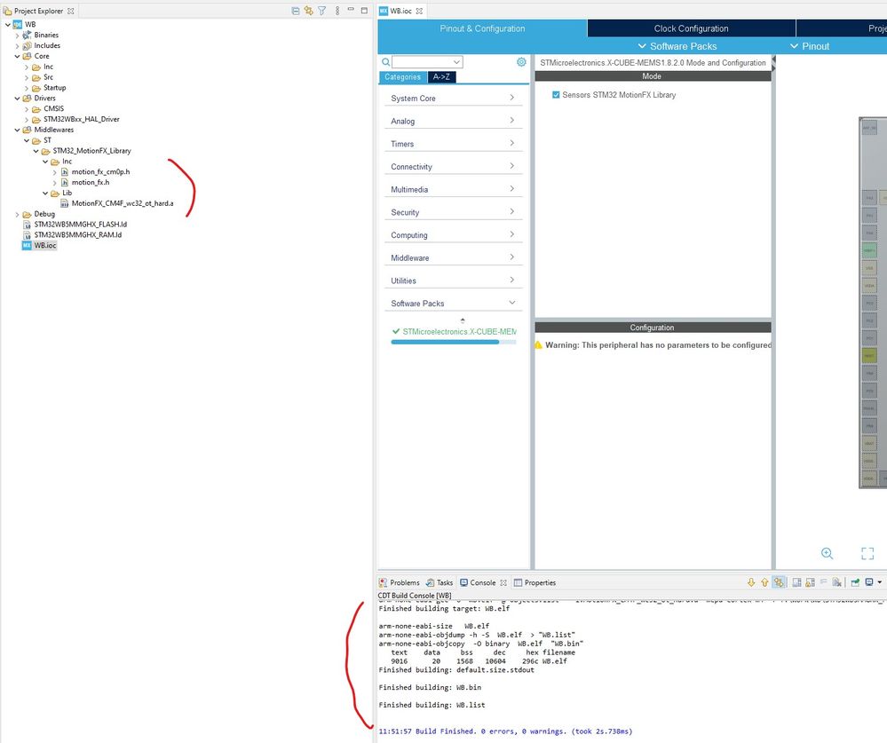

I use STM32WB - CortexM4.
But i have the same problem with all the functions in motion_fx.h and motion_fx_cm0p.h.
My IDE can't find the reference to these functions

Works for me if STM32CubeIDE 1.5.1 & MEMS pack 8.2.0.
Please note .a file is used (archive file <=> precompiled code) ... I guess function implementation is part of.

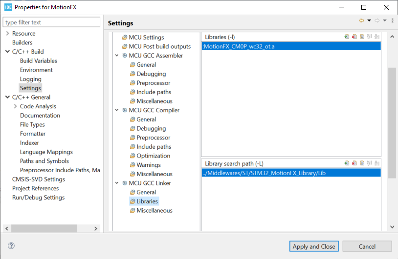

Exactly. The last (linker) step in the build console should link that library (-l). Exact name depends on MPU core.

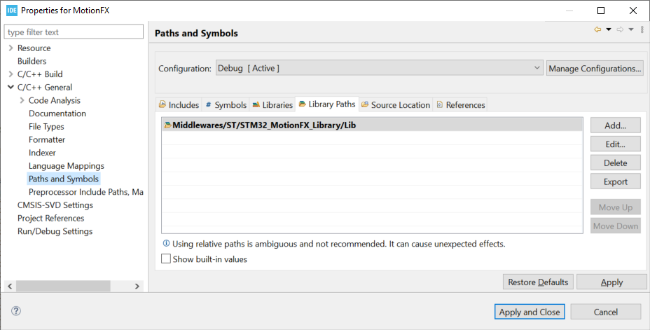

arm-none-eabi-gcc -o "MotionFX.elf" @"objects.list" -l:MotionFX_CM0P_wc32_ot.a ...If not, check that the library is in project properties:

Thank you,
I added Library Paths like you but it cannot find the MotionFX_CM4F_wc32_ot.a
I don't know how to link to .a file

Thank you for all support,
Finally it works for me :beaming_face_with_smiling_eyes:
For information, with Cortex M4 we need to config the Floating point to work with MotionFx. More information here :
