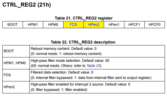

CTRL_REG2 : 0x14
- High-pass filter normal mode.
- data from internal filter sent to output register.
- High-pass filter enabled for interrupt 1 source.

2018-03-19 8:59 AM
OK, I see the problem.
In the configuration CTRL_REG2 : 0x18 you enabled the high pass filter for interrupt 2 source, but then you configured interrupt one (INT1_CFG : 0x2A, INT1_THS : 0x02). So the data without high pass filter are compered with the threshold in the interrupt 1.
You should set the CTRL_REG2 to 0x14.
2018-03-19 9:06 AM
Thank you for your response, but unfortunately I misread my own configuration.
I am actually configuring CTRL_REG2 with 0x14 instead of 0x18.
