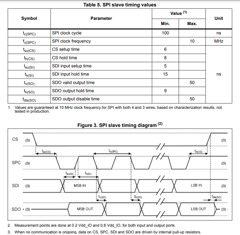

Another point to test is to check the timings you can find in the p.11 of the datasheet:
Can you confirm they are fulfilled?

All of the timing parameters are met except for t_dis(SO), which is very out of spec at ~650 ns (compared to the maximum 50 ns spec). See the attached screenshot. This may point to damage to the H3LIS331, I'm not sure. I don't have access to the pads themselves, only the traces as they leave the chip footprint. I have applied pressure on the chip to try and force contact, but I didn't see a change in behavior.
