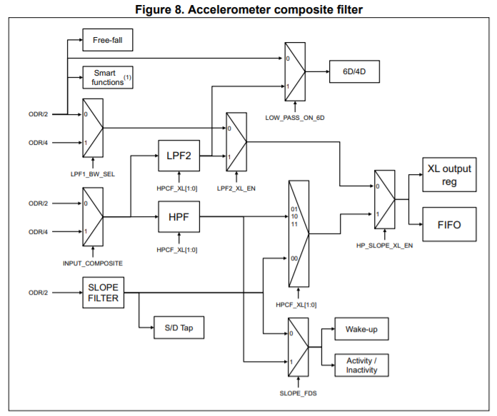

Hi @MSchl.3 ,
I'm not sure this is an issue related to the code itself, but maybe to a limitation in the detection range of the LSM6DSL (max FS = 16g). Do you have a target acceleration value to be detected? I mean do you know how many "g" you would expect b y the shock you would detect?
It's not so difficult to reach up to 10g, if the shock pulse is short enough. You might set some filters (low pass and high pass) on the LSM6DSL, so that you can concentrate the shock you want to detect and reduce the spurious acceleration peaks.
To do this, you can use the Composite filter described in the datasheet, p.67:
If you are using the TAP interrupt, you might try to increase the Interrupt duration, so that the shock must be over threshold for a minimum time (to be fine-tuned with the specific application).
Otherwise, you might try changing device using an high-g accelerometer (up to 200g) such as the H3LIS331DL, which is more suitable for the shock detections.
Otherwise,

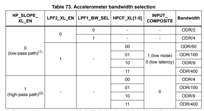

Hi Eleon,
thanks for your reply.
We have made an improvement by making the settings in this strict order:
lsm6dsl_write(accel, LSM6DSL_CTRL1_XL, 0x74);
lsm6dsl_write(accel, LSM6DSL_TAP_CFG, 0x8E);
lsm6dsl_write(accel, LSM6DSL_TAP_THS_6D, 0x42); //previously 0x82 without 6D
lsm6dsl_write(accel, LSM6DSL_CTRL8_XL, 0x01); //enable Filters 0x09 Extreme: 0xE9
lsm6dsl_write(accel, LSM6DSL_INT_DUR2, 0x06);
lsm6dsl_write(accel, LSM6DSL_WAKE_UP_THS, 0x01);
lsm6dsl_write(accel, LSM6DSL_WAKE_UP_DUR, 0x00);
lsm6dsl_write(accel, LSM6DSL_MD2_CFG, 0x40);
lsm6dsl_write(accel, LSM6DSL_MD1_CFG, 0x20);However when we try to apply LowPass or HighPassFilters with this settings:
LPF1_BW_SEL = 1 (thus CTRL1_XL = 0x76)
and CTRL8_XL = 0xE9 ((11101001)) the system hangs and cant read out any more data.
Any hints?
What would be the minium setting for a Low Pass Filter with the above basic settings?
Thanks a lot

Hi @MSchl.3 ,
glad to see you made progressions on your issue.
Not sure it is possible to apply both Low pass and High pass filter, since from the block diagram of the composite filter they are not on in cascade.
You should choose only one of them, maybe only the high pass path, that cuts all the low pass frequency. You will be able to see only shocks faster than ODR/x.
-Eleon
