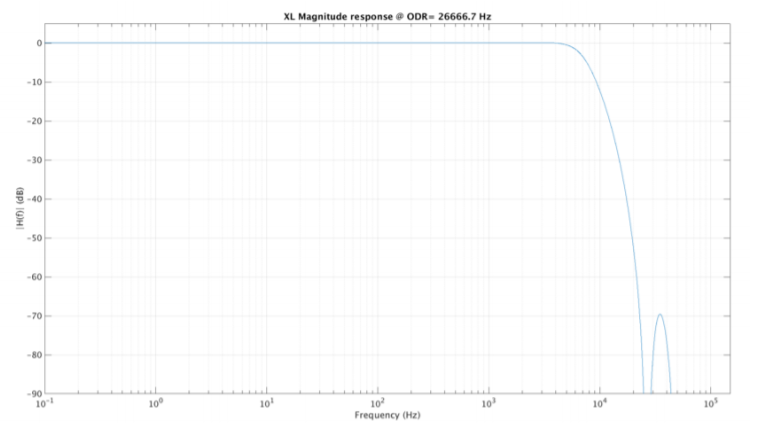

Consider please also that the flatness of the frequency is guaranteed up to about 7kHz (see datasheet, p.19), since this is the f0 of the MEMS structure:
