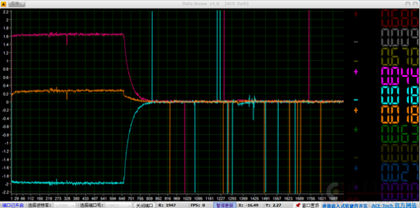

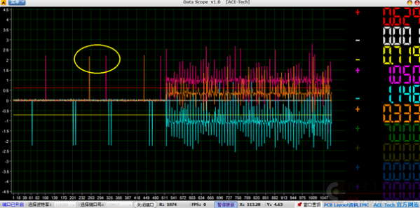

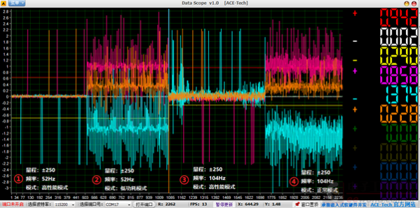

In the process of using STM32 board to collect data from lsm6dsl module, the angular velocity data of gyroscope can be output stably, but there are jumps in the angular velocity of three directions.
In the high performance mode I set, the range of the gyroscope is 250dps, the frequency is 52hz, and the peak value of the jump is 2.2dps (the peak value is stable, and it feels like being limited).

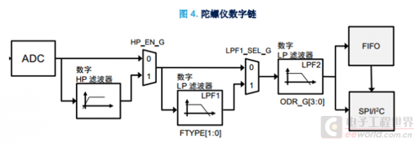

According to the gyroscope digital chain:
I have opened digital LP filter (lpf2), digital high pass filter (HPF) and digital low pass filter (lpf1), but I have not improved the jump.
Do you know what the problem is ?
