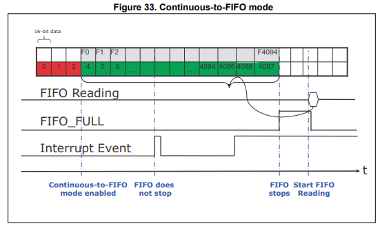

  1. In the continuous-to-FIFO mode, the FIFO buffer starts operating in Continuous mode and switches to FIFO mode when an event condition occurs (see p.99 of AN4650)
  2. Let me check if I well understood... if you set "300" as FIFO watermark, and your device is running, when the tap interrupt is risen the FIFO starts collecting up to 300 samples, and when this watermark is reached the FIFO itself rises an interrupt and it stops filling. If you want to acquire more samples, you have to increase the FIFO watermark value.
  3. The LSM6DS3 FIFO is 8 kbyte sized (p.1 of AN4650), meaning you can store up to 4096 samples of 16 bits each.
