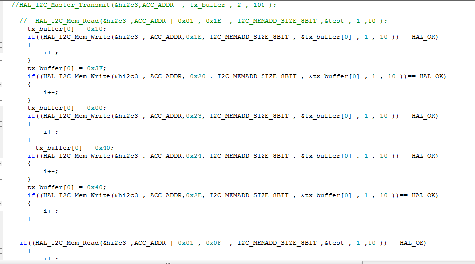

I am trying to get data over i2c from LIS2DE12  sensor. Here I am attaching a screenshot so you can see the way I am configuring its register to read data for x,y and z axis. I dont want to use any interrupt. Simply want to read data.

I want fetch data from LIS2DE12 sensor continuously over I2C. I have configured this sensor as given below.
  • CTRL_REG0 = 0x10  // (0: pull-up connected to SDO/SA0 pin )
  • CTRL_REG1 = 0x7F  // ODR = 200Hz, LPen = 1, All axis enabled
  • CTRL_REG4 = 0x00  // Continuously data updation, 2g, Normal mode
  • CTRL_REG5 = 0x40 // Fifo enable
  • FIFO_CTRL_REG= 0x40 // Fifo mode selection
Below is how I am trying to fetch data from LIS2DE12 sensor. But getting same data again and again even if I move sensor, data dose not get changed.
while (1)
HAL_I2C_Mem_Read(&hi2c3 ,ACC_ADDR | 1 , (0x80 | 0x28) , I2C_MEMADD_SIZE_8BIT , rx_buffer , 6 ,10 );
I am continuously monitoring rx_buffer in watch window. This is what I get in rx_buffer every time I run the program and even I move sensor. No change.
This is how I have configured and trying get data from sensor but not able to fetch properly.

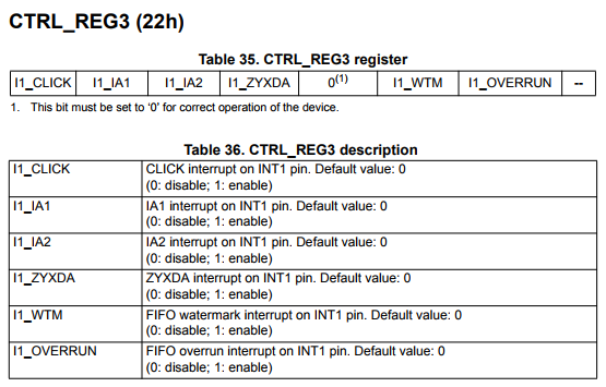

If i use data ready interrupt in INT1 pin. then which configuration i do?

To enable DRDY interrupt on INT1 pin set the bit I1_ZYXDA in the CTRL_REG3.
